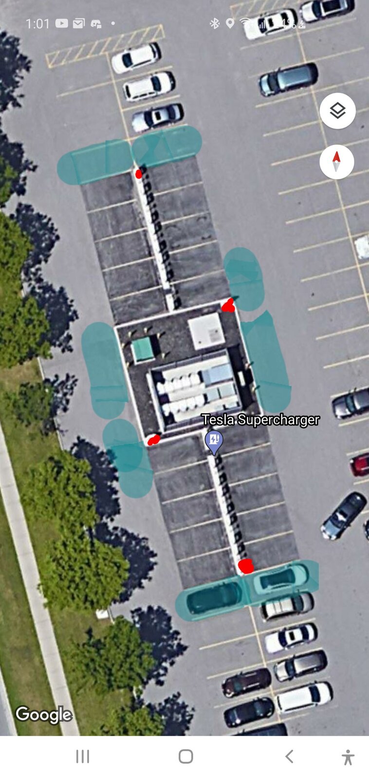

Although not really officially set up for it, I think you could charge in any of the 4 spots I have marked at the local Supercharger without unhitching a trailer
as long as you were respectful of the other cars there.
