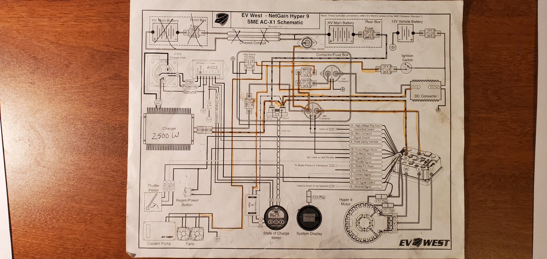

Thanks for the DC fast charger explanation and for taking a look at my set up. Everything in my post is VDC. The panels have diodes, but I am not sure how they are rated. I have attached the wiring diagram, panel cut sheet and the boost transformer. If it matters I will run one panel per boost transformer in case I have a shade issue. I am in the process of adding a more sophisticated BMS I am currently playing with fire and undercharging/manually charging.

You can't use a DC-DC board to provide the voltage needed to DC fast charge a car. It's just too inefficient and too small.
You'd need your solar system to be MPPT and set to that specific voltage of the pack. That's some serious high-voltage stuff.
I've seen trickle chargers set up for 12v to 100v before, but it doesn't seem like it would work for car-sized batteries.
My advice would be to get in touch with the manufacturer and seek their advice or if that's not possible try to find a users group for their products. What you want to do is probably doable but unless you are careful and know what you are doing you have the potential to damage your battery. I think the general approach would be to connect 1 panel to each of the DC/DC converters (those thing are not transformers) and use them as current sources. I note that in your post you called the panels 570 W but the spec sheets list them as 270 W. If they are 270 W panels they will only produce a bit over an amp at 120 V, the maximum the DC/DC converters can produce. Now if the battery voltage is 124 V a 120 V DC/DC converter cannot charge it. What might work, and I emphasize might, is putting the DC/DC converters in series and setting them in current source mode at a little over an amp each. So what is the fully charged open circuit voltage of the battery?
One thing you would have to do for sure is intercept the overcharge signal from the SoC meter and use it to disconnect the panels/converters if it senses full charge.
Getting something like this to work requires extensive knowledge of the battery's charging characteristic and would require extensive experimentation to come up with a safe, effective solar charging system. Saying this as politely as I can your posts indicate that you do not have the necessary knowledge. Therefore I would not recommend that you undertake anything beyond adding in off the shelf components in accordance with manufacturers instructions. Keep in mind that the 500 W you get from two 270 W panels will only add 4% SoC to a 25 kWh battery pack for each hour of FULL sunlight.
