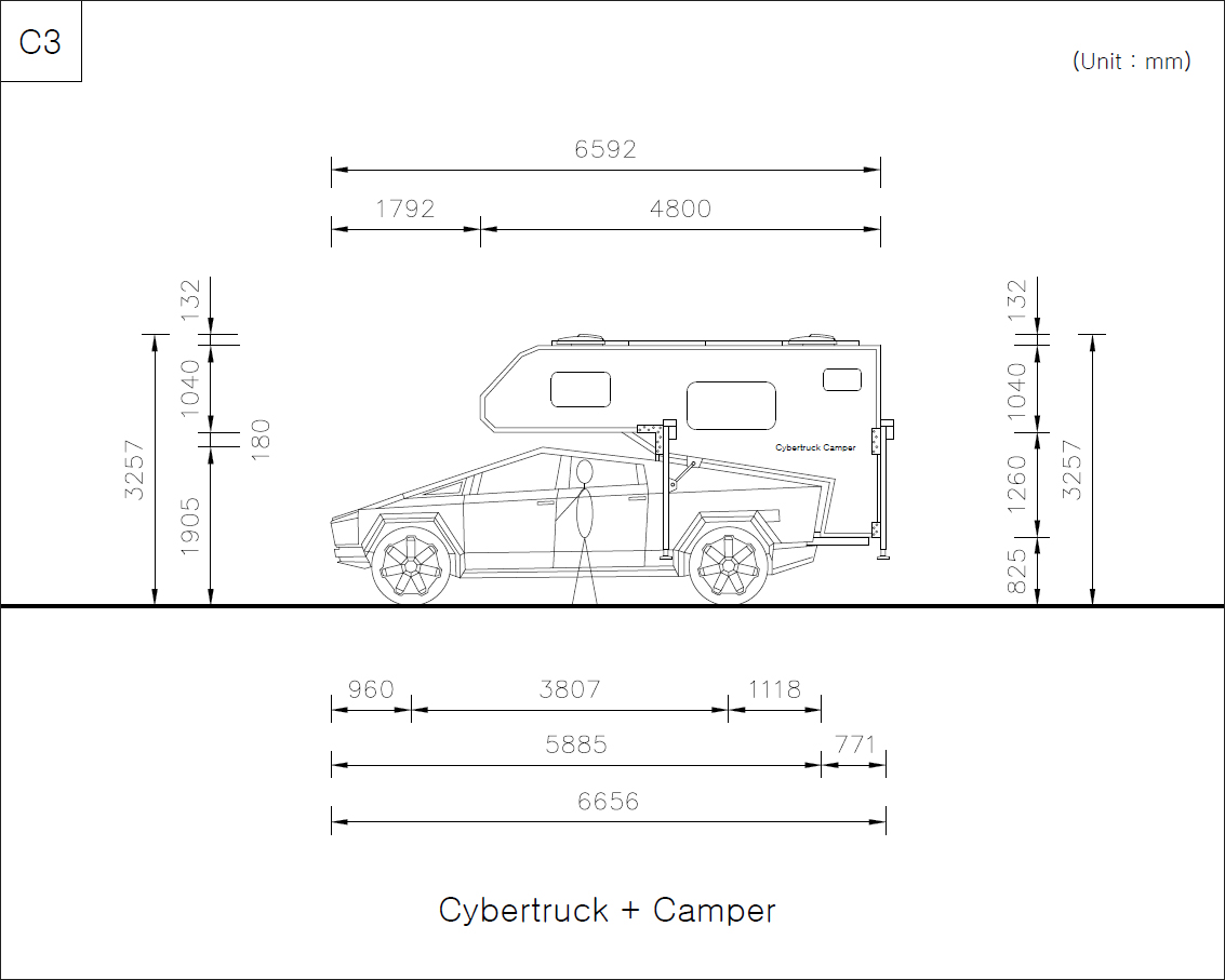

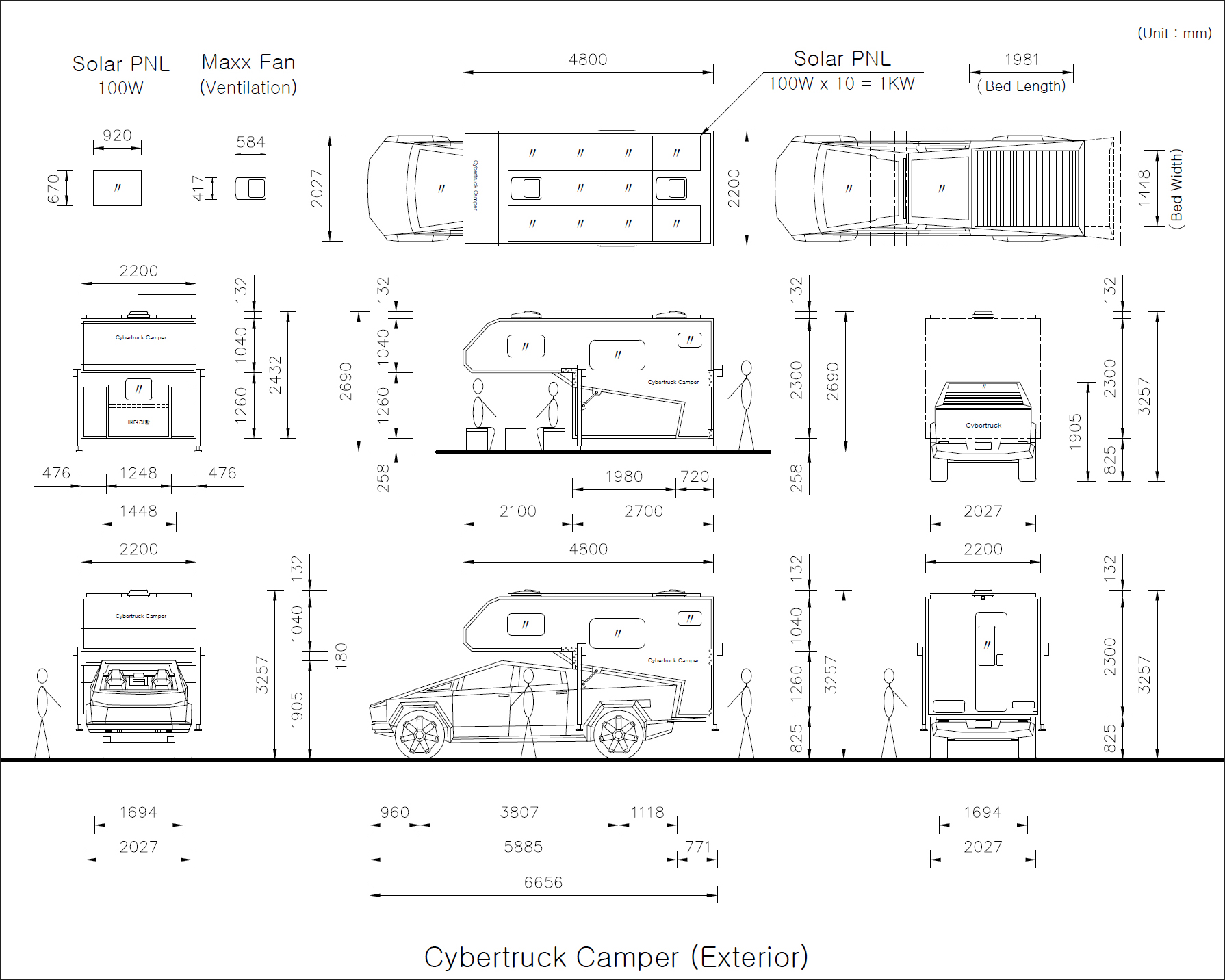

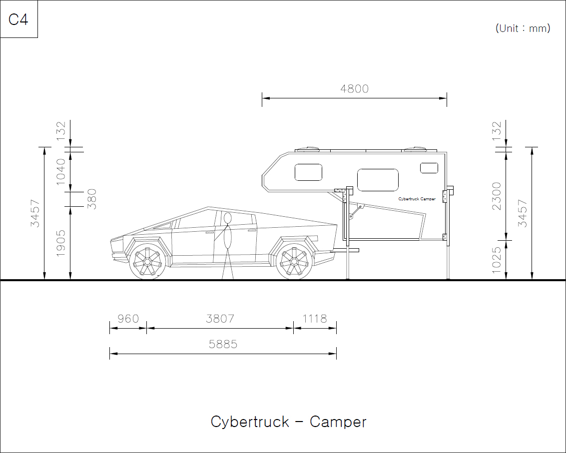

Cybertruck seems to have the advantage of using various camping equipment.
Therefore, I designed a truck camper that can be mounted on a Cybertruck.
The height of the bunk bed has been considered so that there is no discomfort from touching the head to the ceiling when a man sits on the bed.
I hope this drawing will be a reference to those planning to install the Cybertruck camper.
I have attached a pdf file so that you can view high resolution drawings.
