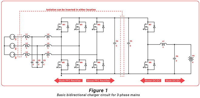

The main reason for choosing this topology is that it is pretty much the simplest one for a bidirectional EV charger that can perform power factor correction over a wide range of EV traction battery voltage relative to that of the mains. Referring to Fig. 1, the three voltage sources on the far left, V1-V3, represent the 3-phase AC mains (wired in wye, though they could be wired in delta with no functional difference), while the battery symbol on the far right, V4, represents the EV traction battery.
MOSFETs M1-M6, along with inductors L4-L6, operate as a 3-phase boost converter when in charging mode, and a buck converter in discharging mode, and as long as the DC link voltage (buffered by reservoir capacitors C4 and C5) is higher than the peak voltage of the AC mains, near unity power factor can be achieved. MOSFETs M7 and M8, along with inductor L7, comprise a bidirectional DC-DC converter that can operate as a buck when M7 is modulated and M8 is freewheeling, or as a boost when M8 is modulated and M7 is freewheeling.
Those of you paying close attention will have noted that L1-L3 have yet to be mentioned. These inductors—more commonly referred to as line reactors in this position—are inevitably required to meet surge and electromagnetic compatibility (EMC) requirements, so they are typically purchased ready-made as pre-approved components.

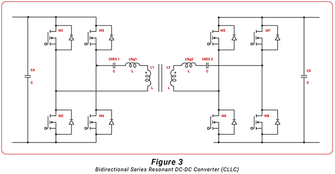

There are numerous circuit variations that address some or even all of the aforementioned downsides—adding either passive or “lossless” snubbers is the most obvious—but a particularly compelling option is to make use of the transformer leakage inductance as part of a series resonant network by inserting a calculated amount of capacitance (and, optionally, additional inductance) in series with each side of the transformer, then driving the bridge switches with a fixed duty cycle at the resultant resonant frequency (see Fig. 3).
This changes the shape of the current waveform from squarish to sinusoidal, which dramatically reduces switching losses, and it also absorbs any other stray inductances (besides transformer leakage) into the series resonant networks, eliminating the need for snubbers and allowing much higher-frequency operation.
There are two downsides to series resonant operation: output can only be regulated by varying the frequency so it still can’t limit overcurrent when operated at a fixed duty cycle; and the stability of the resonant frequency depends on the value of components (and strays) not drifting too much with time and temperature. Both of these issues have prevented wider adoption of this topology, but DC fast chargers are expensive and relatively low-volume products, so having to tweak the frequency on a per-unit basis isn’t quite so painful as it would be for, say, a Level 1 charger.
