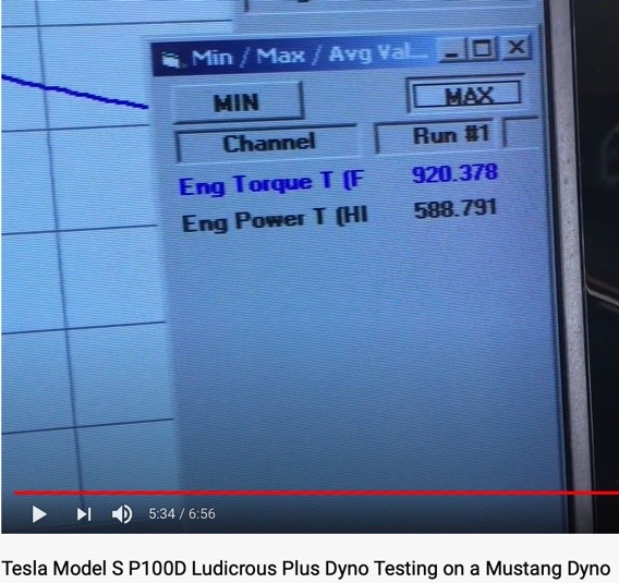

Here is a Model S P100D dyno results
Source: Tesla Model S Dyno
Do you think the Cybertruck Tri Motor will beat that? Yeah, I think so! ?
I forgot to mention in the video they said there was some slippage during the testing and could have made more HP and Torque without the slippage. The Tesla Model S P100D just couldn't be restrained!
Kinda Like trying to restrain Frankenstein........
Cybertruck will be a monster!
