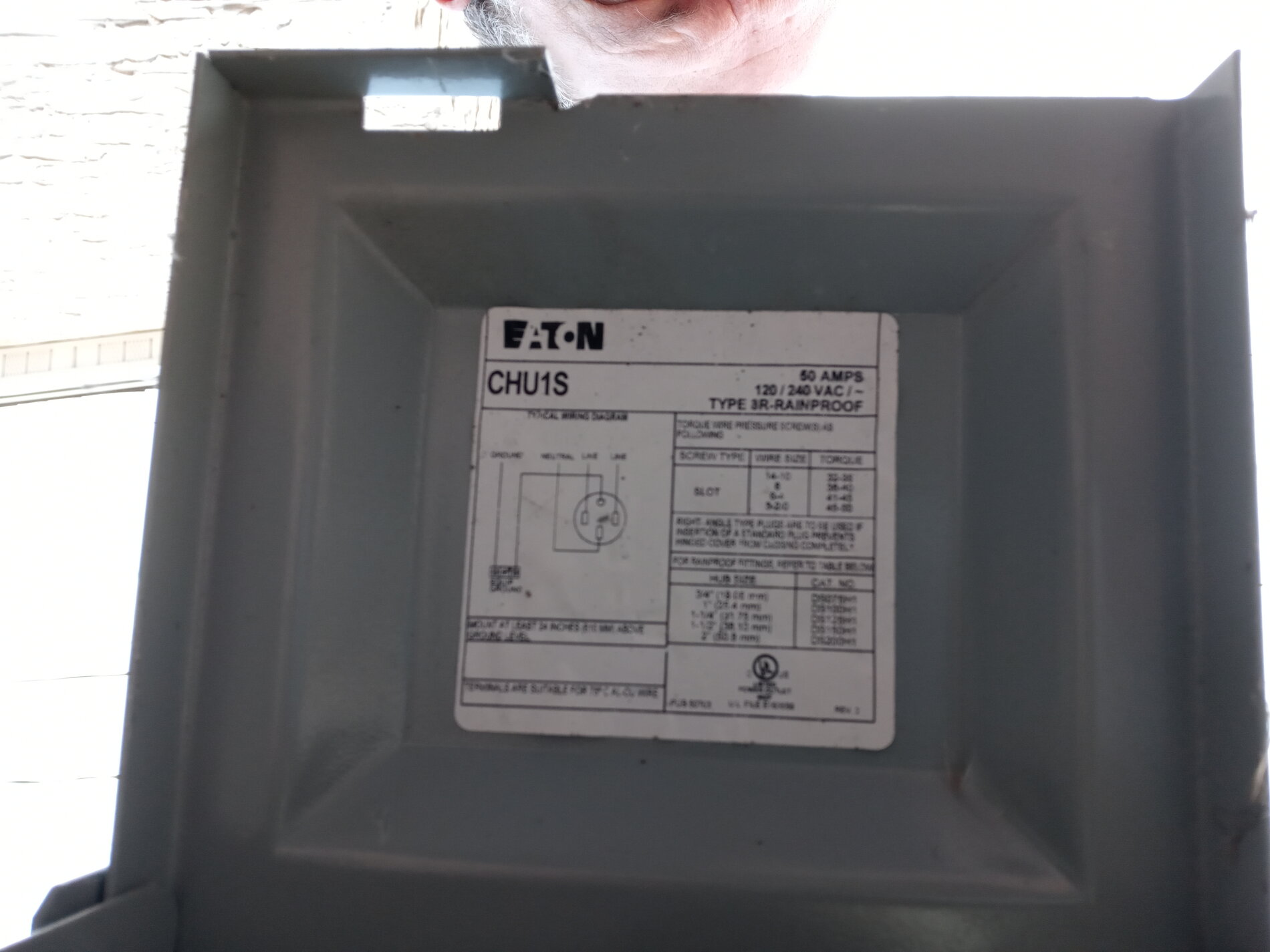

ajdelange:
Oh crap, I missed that Article.
See attached images.
I installed a pair of Eaton "CHU1S" receptacle/junction boxes,
The plan was to have one (50 Amp) receptacle for portable EVSE(s) and a pull-through to a second (80 Amp) hard-wired EVSE.
Now that my eyes have been opened to Article 625.43, I will have to find some other box to serve as a disconnect box, preferably both a weather resistant disconnect AND NEMA 14-50 box. NUTS.
Oh well, at least it was caught BEFORE the conductors were pulled.
Now I just need to know if/when Tesla will make a (80 x 0.80 =) 64 Amp version of their NEXT "Wall Connector", just in time for the CyberTruck's release.
